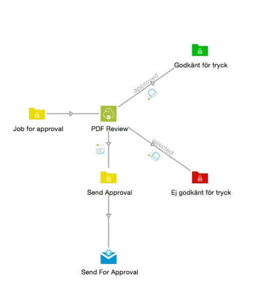

If you add the %option% to your URL for approved/rejected/commented pages does the %option% have to be the same thing as the outgoing folder name? I.e. approved/rejected/commented or whatever?
If so, that would be a bit disappointing for us non-english speaking, as for instance "Godkänt för tryck" wouldn't be a good URL... :lol:

I second that.
A possibility might be some kind of translation with .htaccess or virtual paths...
In short, cool function, but unfortunately not very useful :-/

Well, it's useful as long as you're not using å, ä or ö in the name of the outgoing folders.
Unfortunately for us that means we have to settle with OK and Felaktig PDF or any similar phrases that doesn't contain å, ä or ö.
On the other hand, since we represent less than 0.01 percent of the users we can't demand that Enfocus fix the issue ASAP.
It would however be nice if it was possible to set a variable for the URL, either the full path or just the final part of the path, in the outgoing connection, that could be used for the different pages you want to display, kind of like you do with the Inject job configurator, or if you could use the name of the connection rather than the outgoing folder for the URL.
