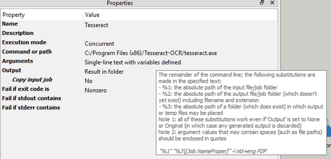

These are the execute command settings I have:
Screenshot 2020-07-31 at 12.02.43 copy.jpg (91.85 KiB) Viewed 22635 times
