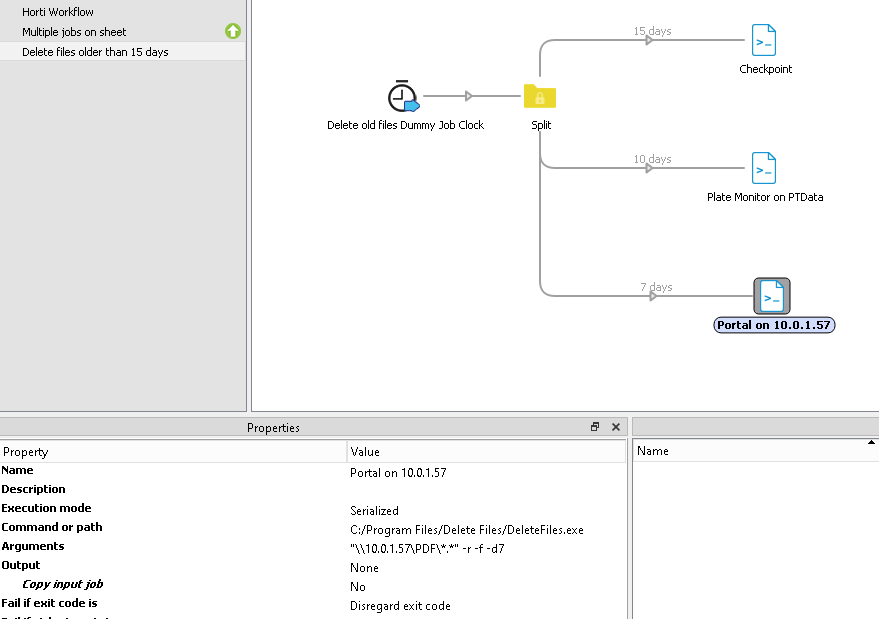

Anyways, back to topic, my creative way of deleting old files is by using free and open source app called "Deletefiles".
https://github.com/RickStrahl/DeleteFiles
You call it from Switch and pass parameters, it works with both local and network paths.
I also had to use third party app "Dummy Job Clock" for another simple task, timer.
See screenshot of simple flow and it's configuration I use. It has been solid for years.
Basically timer fires up dummy file (once a day, once a week, etc...) and it executes Deletefile with parameters.
I hope this helps.
