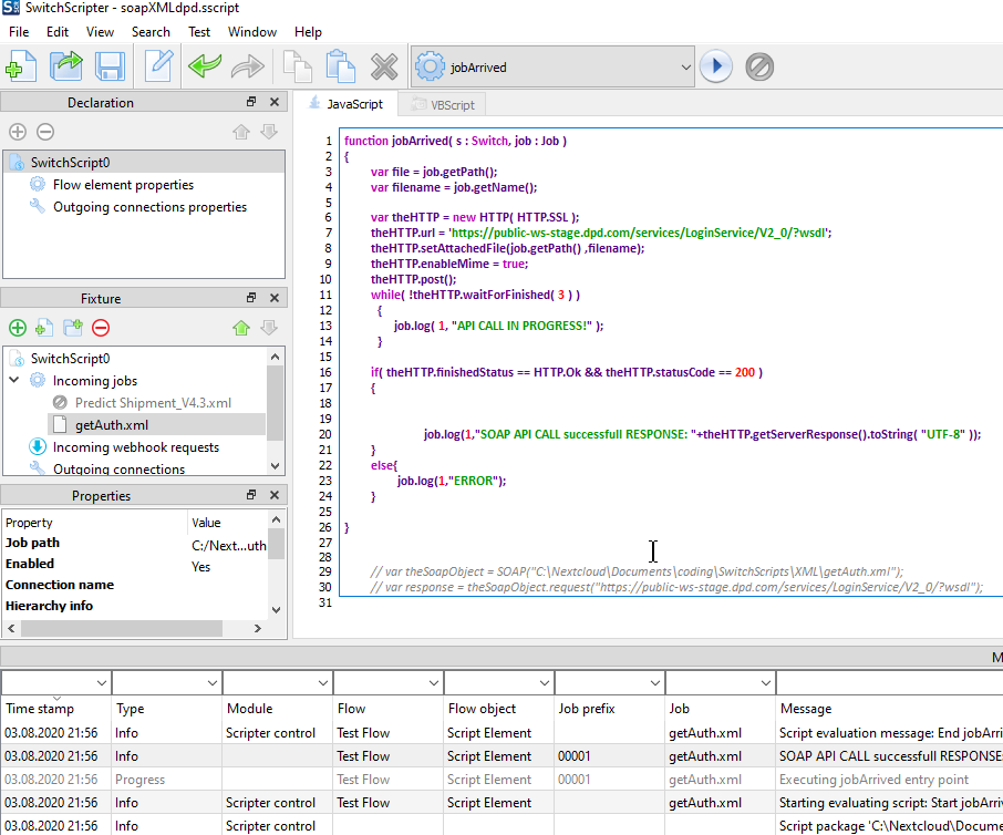

I would love to use http instead but I have no clue on how to get started.
Lets say I create a http object and as URL i specifie the wsdl link.
How should i send the XML file? With setAttachedFile()?
Wich Method should I use, post?

Whether you have to POST or GET are things you have to find in the DPD documentation. SOAP API's generally use POST, but GET is technically allowed. Also the content of the HTTP headers you have to send is something you will find there. Whether you have to upload a file (setAttachedFile) or place the XML in the body (setPostData), whether you have to use MIME encoding or not -> documentation. And what do you have to do with the answer? I cannot help you further without studying the DPD API and running some tests. I am sure you will understand that this is over and beyond the effort acceptable for a forum.
My advice: DPD package in Node.js. At least you will not have to worry about the technical details of the API implementation.
