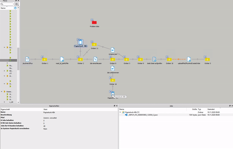

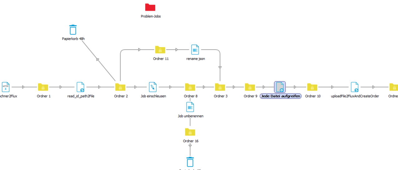

Okay this worked for me now:
var dataset = job.getDataset( "OpaqueJson"  );
var jsonFilePath = dataset.getPath();
var jsonFileObj = File.read( jsonFilePath ,'utf-8');
var orderJson = JSON.parse( jsonFileObj );
Bildschirmfoto 2020-11-20 um 10.57.22.png (83.66 KiB) Viewed 10262 times
