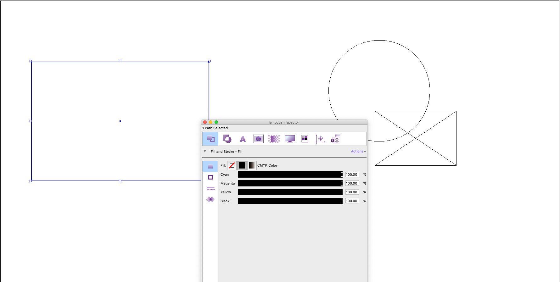

Screen Shot 2020-11-12 at 3.40.25 PM.png (93.15 KiB) Viewed 14844 times
So I just need to understand what needs removing.
You can see the file in Wireframe mode here.
You have a circle and a rectangle of 100% CMYK.
You have a form (that thing that shows with a X in it)
And around the outside of the Media Box you have a path.
Which elements do you want to remove?

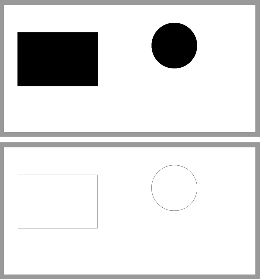

Re: Remove object with white background or background with 0% opacity
Posted: Tue Nov 17, 2020 9:18 pm
by abailescollins
Ok, so this?
Top what it looks like, bottom wireframe.
I did this manually in PitStop Pro.
Do you need to automate it, if so are the objects in exactly the same positions in each file?
Posted: Wed Nov 18, 2020 11:00 am
by schmitzdp
Yes, the result is this one.
Yes, I want to automate it with a list of actions.
