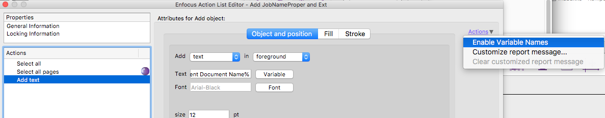

Ahh, you won't see the variable you created if you just click the button "Variable". That only shows the prebuilt variables. In the upper right corner of the dialog you should click on "Actions" and choose "Enable variable names".
The attachment Skærmbillede 2018-06-23 kl. 13.57.08.png is no longer available
When you have done that there is a new light blue ikon in the value field. Click that and select the variable set you created and then the variable you want to use.
