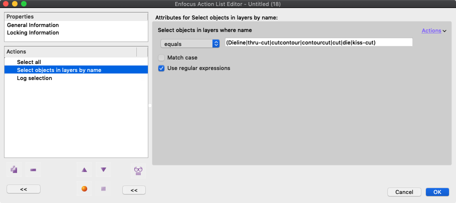

When you use regular expressions you don't have to use a single select for each layer name, you can all combine them in one select action with a regular expression. The following one will literally match any layername in your list:
(Dieline|thru-cut|cutcontour|contourcut|cut|die|kiss-cut)
Screenshot 2020-08-12 at 08.53.23.png (47.72 KiB) Viewed 13463 times

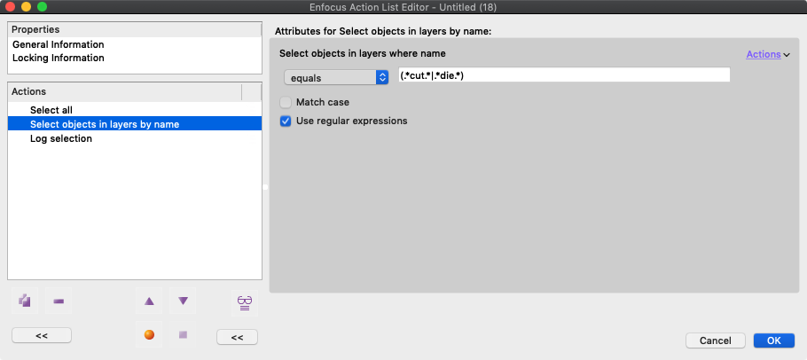

When we are already using regular expression, we can also build one which matches anything containing cut or die:
(.*cut.*|.*die.*)
