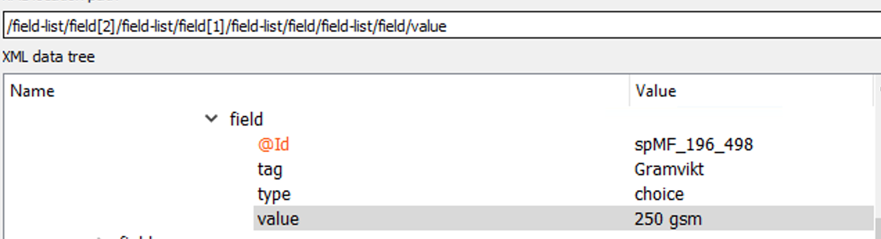

I googled EXIFTool and found a page with Command-Line Examples and it shows this: exiftool -artist="Phil Harvey"
Have you tried the double quotes?
Also -Creator=[Metadata.Text:Path="//field[tag='Name of the metadata field']/value",Dataset="Submit",Model="XML"] "%1" makes it easier to understand what metadata is being used and also means that if you change the order of the metadata fields in the submit point you will still get the correct metadata. 8-)
So instead of /field-list/field[2]/field-list/field[1]/field-list|field/field-list/field/value you would write //field[tag='Gramvikt'] to get the value 250 gsm in the screenshot below.
Skärmavbild 2019-10-14 kl. 07.43.01.png (107.76 KiB) Viewed 13795 times
