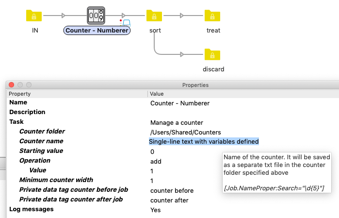

Hi Mark,
Use the Counter - Numberer app https://www.enfocus.com/en/appstore/product/counter
Create a counter for each order number, counter name = [Job.NameProper:Search="\d{5}"]
Sort the jobs on the condition [Job.PrivateData:Key="counter after"] equals 1 -> treat, All other jobs -> discard
