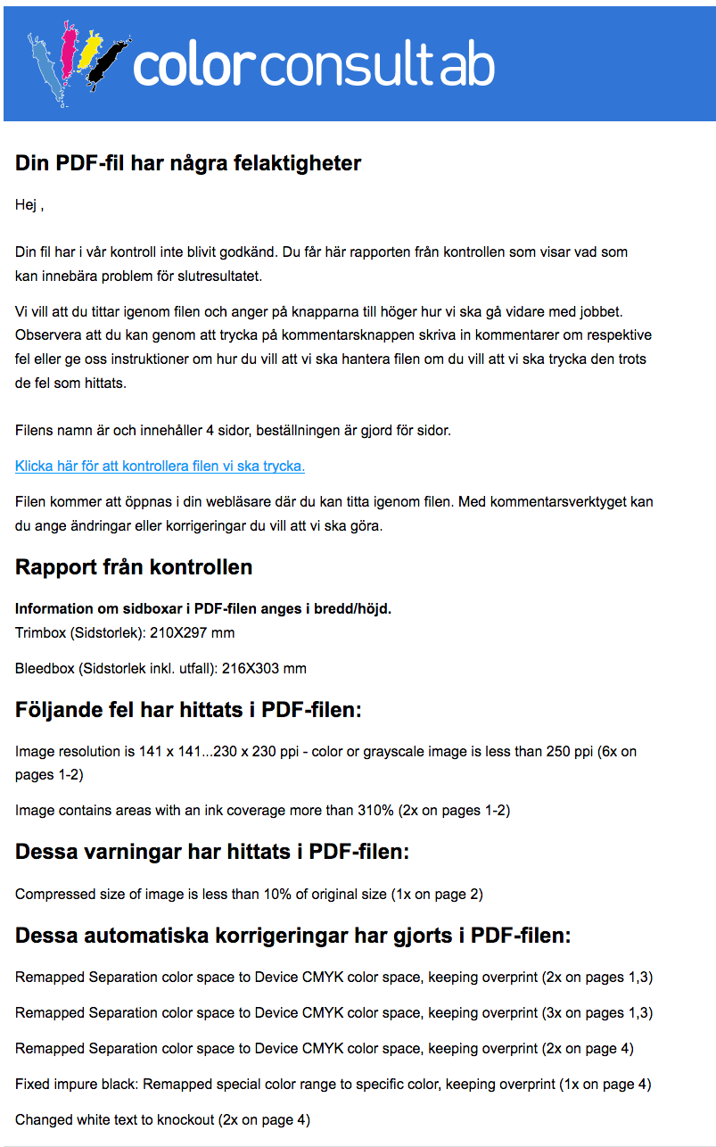

jan_suhr
Posts: 707
Location: Nyköping, Sweden
Re: PDF Review Module
Post by jan_suhr »
This is better and give the information needed. :D
What you get for errors, warnings or fixes depend on what your profile is checking for.
