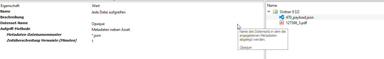

For Example I have this flow where I want to opaque pickup a *.json file in a *.pdf file but it stucks before the pickup flow element.
Why is that? :?:
The attachment 2020-11-15 09_42_18-Enfocus Switch - Switch Server (localhost) - euchnerSwitchFlux.png is no longer available
2020-11-15 09_42_18-Enfocus Switch - Switch Server (localhost) - euchnerSwitchFlux.png (16 KiB) Viewed 30232 times
Benjamin

2020-11-15 09_46_43-Enfocus Switch - Switch Server (localhost) - euchnerSwitchFlux.png
2020-11-15 09_46_43-Enfocus Switch - Switch Server (localhost) - euchnerSwitchFlux.png (11.49 KiB) Viewed 30232 times
Benjamin

Do both files have the same name?
Jan Suhr

jan_suhr wrote: Sun Nov 15, 2020 11:05 am Do both files have the same name?
No its 470_payload.json and 127398.pdf as u can see on the screenshot.

Sorry I didn't see that.
But that is your problem. For the Pickup tools to work with the setting "Metadaten neben Asset" both files have to have the same name.
So you have to find a way to rename the payload file.

jan_suhr wrote: Sun Nov 15, 2020 1:52 pm ...
Is it not enough to rename one of the files? Image
They still have their unique filename for a second.

You renamed the payload file and also changed the extension. The filename before the extension must be alike but different extensions. The filetype you want to embed as an opaque datatype i specified in the properties.
You you need two files as this: myfilename.pdf and myfilename.json
