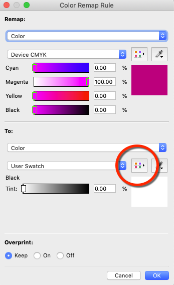

I did try to use remap color but the only option was user swatch and I couldn't figure out where to set the user swatch color

Just hit the button next to "User Swatch"
...and then create an new spot color called "Knife".

Ok so there is no button next to user swatch. I may need to uninstall and reinstall pitstop server. All I get is a black square

Ahh, you might need a PitStop Pro to do this. Apparently you can't create a new spot color from within PitStop Server. I wasn't aware of that :roll:
You can however create the action in PitStop Pro and run it in PitStop Server.
PitStop Server indeed does not include the colour picker. There is one action ("Remap spot color") that can create a new spot colour without needing the colour picker, but it only works if you're starting from another spot colour.
So, a workaround could be: create an Action List that first usese "Remap color" to convert the correct objects to "Black" - because you can't pick a different colour in PitStop Server. Then, still having the same objects selected, use "Remap spot color" to "Knife" with a CMYK alternate.
Or if you don't care about the alternate you could use "Rename spot color" instead of "Remap spot color".
