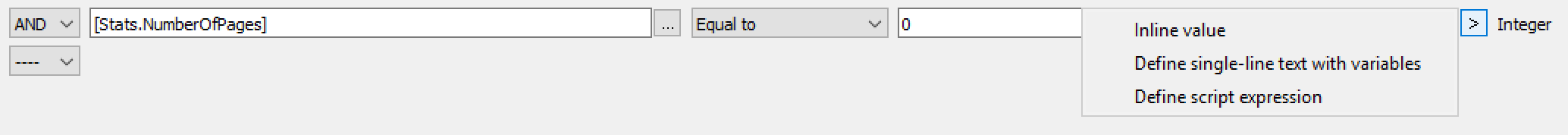

I know I can use Pitstop Server preflights to check for an odd number of pages in a document but I'm looking to keep things tidy and do it with a branch of a flow using Stats.NumberOfPages (see attached).
Do anybody know/care to share how I could do that via the scripting expression?
TIA

Off the top of my head I can't figure out doing it through Define conditions with variables, but doing it fully in a Script expression on a connection would be done like this:
var numberOfPages = (new FileStatistics(job.getPath())).getNumber("NumberOfPages");
(numberOfPages % 2 == 0);

FYI
Got there in the end
[Switch.Calculation:Expression="([Stats.NumberOfPages]%2)"]

abonsey wrote: Thu Sep 17, 2020 2:59 pm FYI
Ah! Can't believe I didn't think of that
