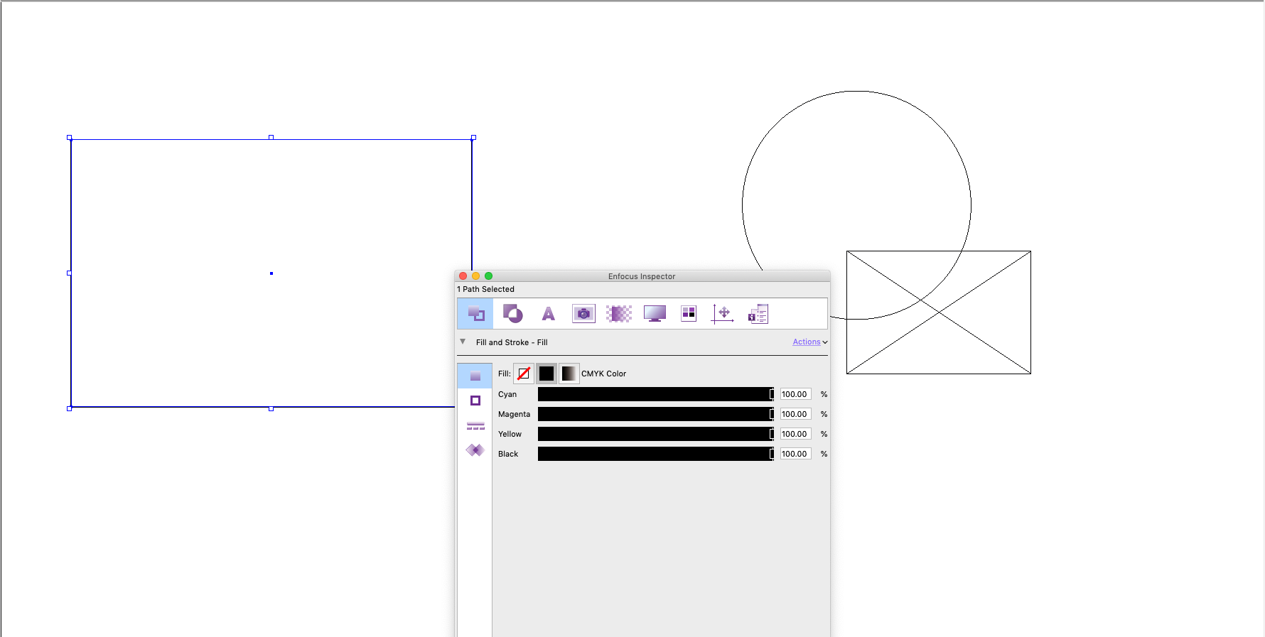

Screen Shot 2020-11-12 at 3.40.25 PM.png (93.15 KiB) Viewed 16735 times
So I just need to understand what needs removing.
You can see the file in Wireframe mode here.
You have a circle and a rectangle of 100% CMYK.
You have a form (that thing that shows with a X in it)
And around the outside of the Media Box you have a path.
Which elements do you want to remove?

abailescollins wrote: Thu Nov 12, 2020 3:43 pm So I just need to understand what needs removing.
You have a form (that thing that shows with a X in it) This one which has a black and transparent background
And around the outside of the Media Box you have a path. This one which has a white background

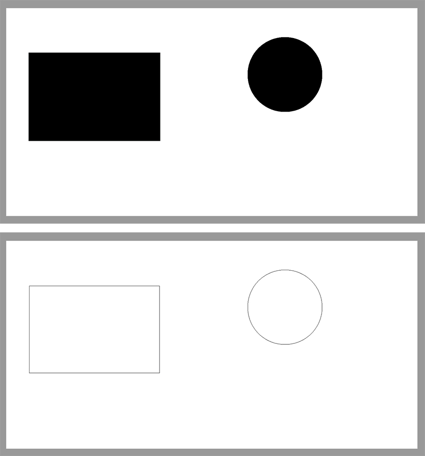

Ok, so this?
Top what it looks like, bottom wireframe.
I did this manually in PitStop Pro.
Do you need to automate it, if so are the objects in exactly the same positions in each file?
abc@imposition.com

Yes, the result is this one.
Yes, I want to automate it with a list of actions.
The elements will not be in the same positions.
