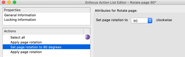

You can easily rotate a page or document this way:
Rotate page 90.png (30.34 KiB) Viewed 5497 times

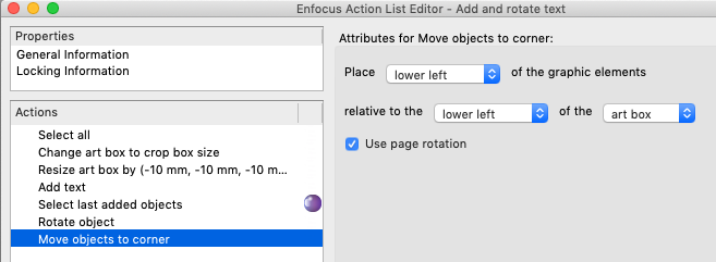

But you don't need to rotate the document, you can add the text and rotate it:
Add and rotate text.png (42.15 KiB) Viewed 5497 times

Tim Murphy
Posts: 16
Joined: Wed Apr 28, 2021 11:50 pm
Re: Rotate page
Post by Tim Murphy »
Hi Laurent,
Thanks for the reply, that solved the problem. Appreciated.
I forgot to mention that I had also tried keyword searches in Pitstop, mainly "rotate", but that particular entry never turned up.
I have a lot to learn :).
