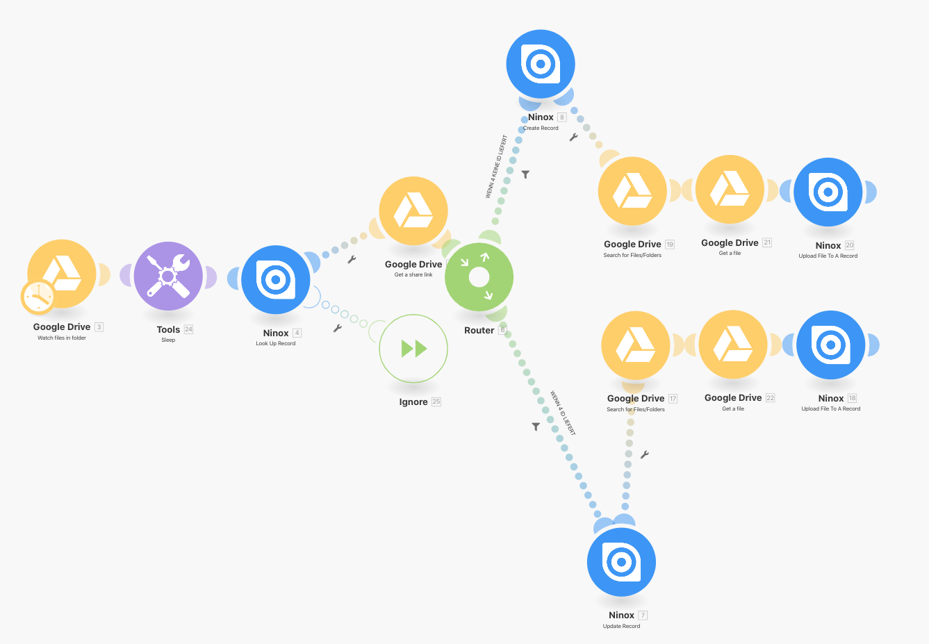

The use-case is rather simple. I try to replace an Integromat Workflow we use as the scenario running over there is getting quite expensive.
Every time a new file is dropped in a switch folder it creates a png from it and saves both files in a google drive sync folder. Integromat watches this folder looks for the filename in ninox if the filename is found it updates the file and share link if not it creates a new dataset in ninox with the png attached and it also creates a share link to the file in google drive and writes it in a field as well. The database is from the sales department and they create orders within this table and as there are many types of products they cant imagine everyone by the name so they need to have a view.
Also the order documents created in ninox will use the png`s as well.

That's the integromat flow:
