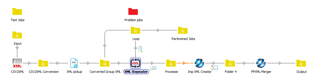

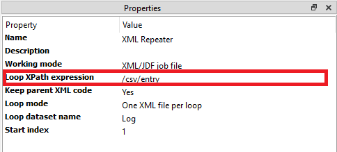

Re: setting up XPath Loop expression
Hello Robert,
Thank you for your reply.
I tried it, but my file is disappearing in messages it is showing "IJT could not be opened: '000GZ.ijt'", attached my flow & XML repeater screenshot. Kindly help.
- Prop.png (6.15 KiB) Viewed 9696 times
- Prop.png (6.15 KiB) Viewed 9698 times
- Flow.png (20.24 KiB) Viewed 9708 times
Re: setting up XPath Loop expression in XML Repeater
Hello Aar096,
please send me your flow and a CSV file (or at least the XML file which comes out of CSV2XML).
Just out of personal interest: why don't you output single XML files for each CSV record from within CSV2XML? Alle you have to do is to switch the script property Output as single XML file from Yes to No.
