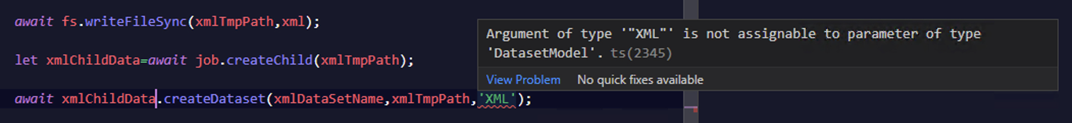

A per the title of the topic I have a question as to why VS Code indicates to me that the property XML is not assignable to DatasetModel?
I have attached a screenshot of this error:
Not assignable error
Documentation states that allowed values for dataset model are as follows: XML, JDF, XMP, Opaque

The createDataset method takes in an enumeration (https://www.enfocus.com/manuals/Develop ... model.html) for the model parameter.
That line should be:
await xmlChildData.createDataset(xmlDataSetName, xmlTmpPath, DatasetModel.XML)

Thanks for the note on this.
