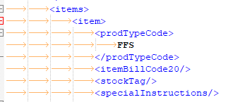

So I saw what you meant about the tabs and we successfully processed this xml through saxonica saxon without using contains() but only if we MANUALLY remove the tabs... Do you happen to know of any saxonica saxon PE scripts that can be used to remove the tabs from the XML?
prodTypeCode - tabs.png (3.97 KiB) Viewed 6216 times
We would need to remove the tab BEFORE and AFTER (on the next line) that is associated with the prodType.
But if we have to apply it to everything, then so be it.

If the value is 'FFS' and only 'FFS' then the only correct way of putting it into an XML is
<prodTypeCode>FFS</prodTypeCode>
Ergo, you should be looking that the code that creates the XML. Is that under your control? If not, then this app can come to the rescue: https://www.enfocus.com/en/appstore/pro ... ng-replace
