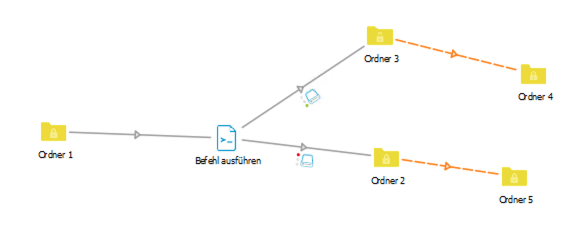

Now to test this I made a simple flow.

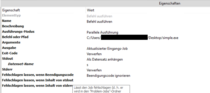

In the options of the "Execute command" module I specified the simple.exe to run without any arguments.
The output should be an updated version of the inputfile and the Stdout should be attached to the inputfile as opaque dataset with the Name "s".
Also the "exit code" is being ignored.
Now the file runs to the success route but the dataset "s" is not accessible and has no value. Why is that?

Opaque dataset is just a link to a file (could be any file type) that Switch keeps in its internal folders. It is a clever way to keep a file together with a job. To get it back as a file or as in this case save it out to be able to read it you have to use the Export metadata configurator. It will save out the file in the Opaque dataset to the outgoing log connection.
This is only possible if you have the Metadata module.
