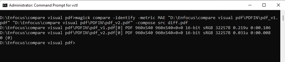

I´m trying to using Imagemagick to compare 2 PDF´s, but I´m getting error even if the PDF are the same!
It´s suppose to get outcode=0 if the PDF´s are the same but I´m getting :
"Execute command      Job failed because outcode is nonzero, outcode = [2]"
I have set with no variables yet because on windows CMD it work´s but in Switch not.
My command line:
magick compare -identify -metric MAE "D:\Enfocus\compare visual pdf\PDFIN\pdf_v1.pdf" "D:\Enfocus\compare visual pdf\PDFIN\pdf_v2.pdf" -compose src diff.pdf

I think ImageMagick uses Ghostscript when working with pdfs.
So maybe it has something to do with the enviroment from the commandline not being present in Switch.
I use this commandline tool https://vslavik.github.io/diff-pdf/ for comparing pdf. Not yet integrate in Switch. But using it locally on my mac.
I do not think it uses any other external tool do it.
