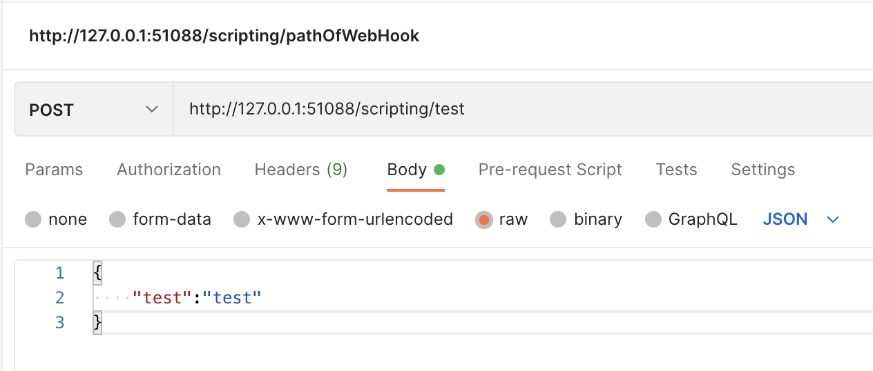

The flow uses the latest version of the Webhooks tool to create the JSON dataset. It can be triggered using Postman like this:
Screenshot 2022-09-05 at 13.02.08.png (70.44 KiB) Viewed 23653 times
