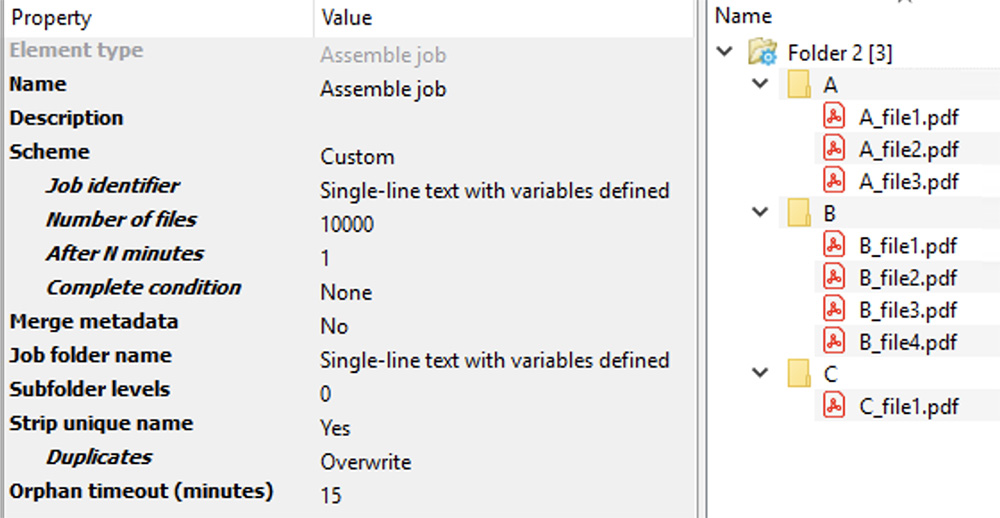

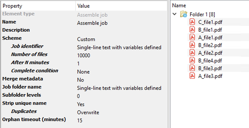

When "Assemble job" you could set Scheme to Custom and set Job indentifier to look for example the first 6 characters of the file name [Job.NameProper:Segment="1-6"] or everything before the first underscore [Job.NameProper:Before="_"], then set Number of files to 100000 and set After N minutes to 1 minutes (or what time-limit suits your workflow).JuBaz wrote: ↑Tue Jan 10, 2023 12:38 pm That's exactly what I do already and it works pretty good The variable for Job Identifier is Job Name --> Search: Analyse or Search:Beratung.
What I wanted to know is, if it is possible not to Search for "Analyse" and "Beratung" but instead set up a variable which checks if the files are named with the same words automatically.
Input:
Output:
Maybe that could work for you?
