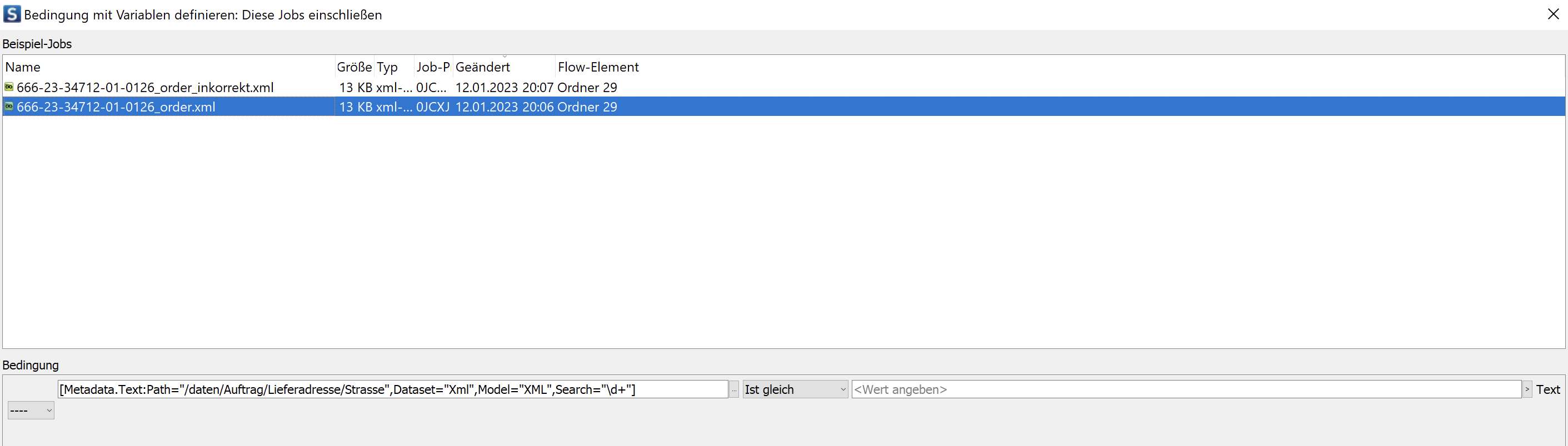

My approach was to set a condition on the route that validates if the value <Strasse> contains a number or not.
I set a path to the value and used a regular expression to only search for numbers (\d+), type of Metadata is Text.
My idea was to validate if the result from that equals an "empty" value then go path A, if there is a value, then go path B.
But unfortunately, I can't leave the field on the right empty.
Any ideas how to resolve my problem?

Try to set the condition to: [Switch.Calculation:Expression="[Metadata.Text:Dataset="Xml",Model="XML",Path="//Strasse",Search="\d+"]"] Greater than 0
Because if you place any numbers inside Switch Calculation you can compare with numbers instead of text.

magnussandstrom wrote: Thu Jan 12, 2023 10:27 pm Try to set the condition to: [Switch.Calculation:Expression="[Metadata.Text:Dataset="Xml",Model="XML",Path="//Strasse",Search="\d+"]"] Greater than 0
Thank you, that worked like a charm!
