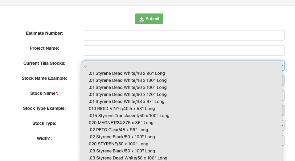

This worked fantastic. Now I need to clean the library up and get the submit point as I want it.
I used the base of the script to populate other items as well. This allows the user to see the stocks prior to submitting a csv for use with Phoenix and if it's not there they can add it on the fly and it'll be added at the time of submit making this a one step process.
Screenshot 2022-12-20 at 9.53.55 AM.png (94.93 KiB) Viewed 155002 times
Thanks again to @mkayyy

Looks great, glad I could help!
