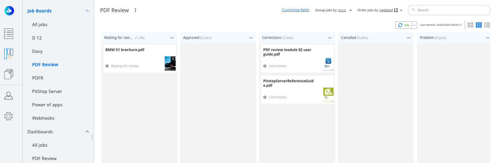

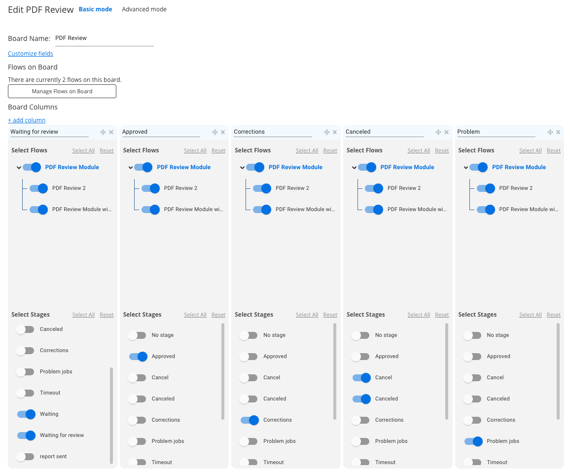

You can use the flow stages and the job boards to have a nice overview of the jobs waiting for review.
To define the flow stages, use the Refresh job info element.
You will be able to create a job board like this:
Job boards
Job boards
PDF Review job boards.png (90.92 KiB) Viewed 10581 times
Job boards is a standard feature of Switch.

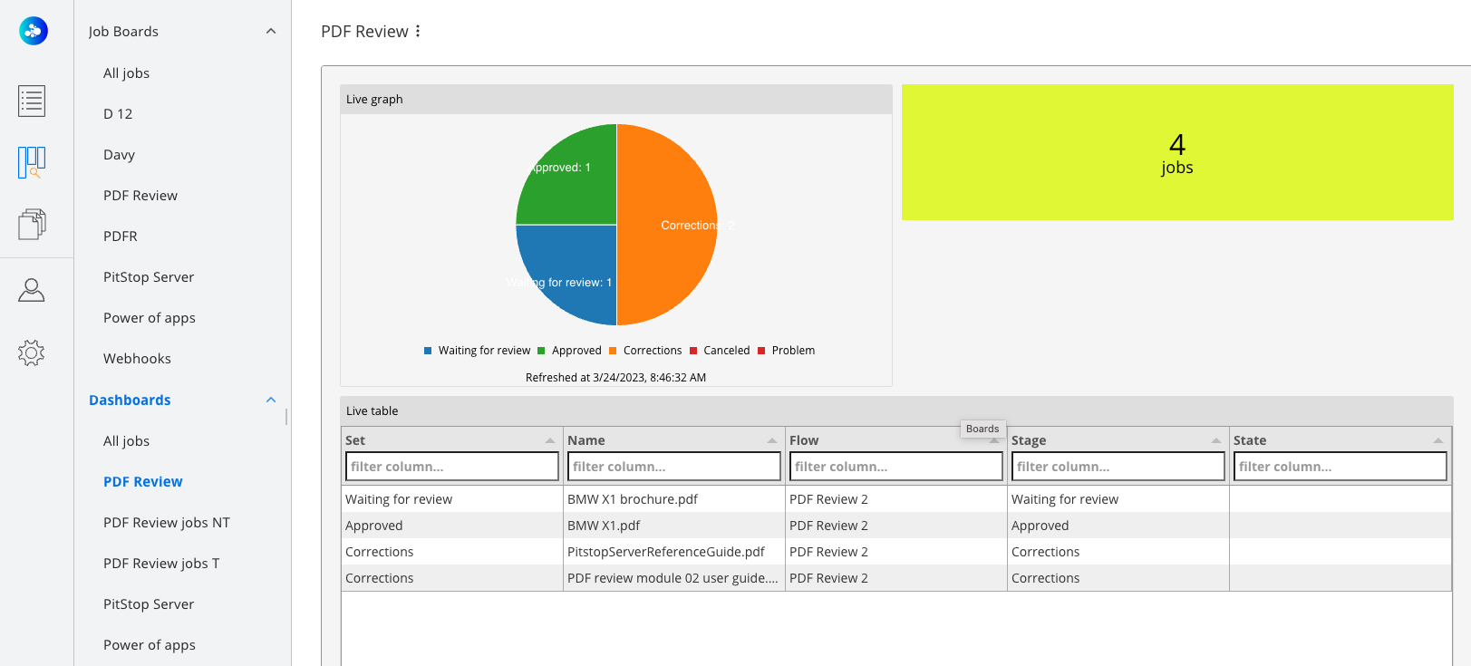

If you add the reporting module, you can also create nice dashboards with graphs, lists, counters, …
Dashboards
Dashboards
PDF Review dashboards.png (112.33 KiB) Viewed 10581 times

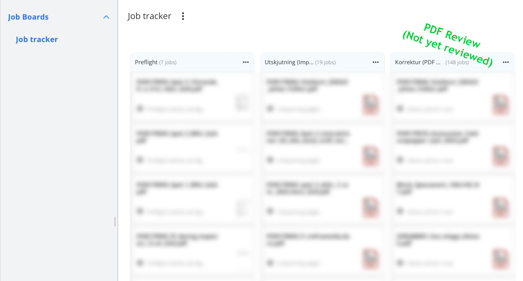

We are using Job Boards for viewing PDF-Review status in Switch Portal (by using the flow element 'Refresh job info' and 'Flow stage').
..but since our portal users (+40 people) do most job handeling in Job Filters (Check jobs) it would be a really good feature if PDF Review could be viewed as a Check Point in Switch Portal as well. Now it's a bit awkward for the user to go 'somewhere else' to look at PDF Review status.
Laurent: I did not know I could use Dashboards like that, I will look into that!

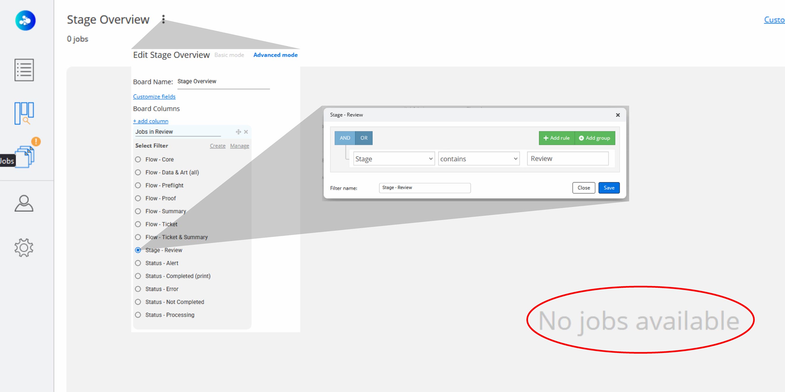

Filter and board setup - board shows nothing!
Artboard 1@3x@0.75x.jpg (128 KiB) Viewed 10523 times
I was expecting the 5 jobs sitting in the Single Holding and Collection Holding folders to be visible on this board. Jobs sit in these folders for a maximum of 12 hours before the review times out.

Here is a screenshot of my job board settings:
job board.png (131.53 KiB) Viewed 10410 times

laurentd wrote: Tue Apr 04, 2023 4:54 pm Here is a screenshot of my job board settings:
I went ahead and gave that a shot, but the board still shows nothing. I've also double checked permissions for all users and flows.
Basic board settings
Artboard 1.png (206.44 KiB) Viewed 10399 times
I'm kind of at a loss here - I might open a support ticket.

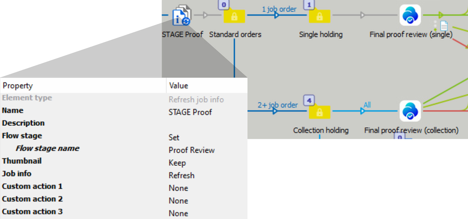

I got this to work just fine. Can you post a screen grab of the 'Refresh job info' properties (STAGE Proof)?

Post by thepkglab_greg »
Refresh job info settings
I've opened a ticket for this, so hopefully it'll be figured out.

Post by magnussandstrom »
That looks accurate, a support case might be the next step. But my best guess is that there is some mistake that exclude the job somehow.
