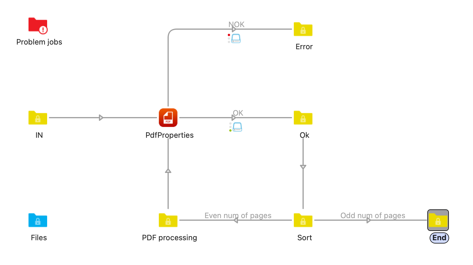

1. What is this and where I can find relevant script?
Screenshot 2023-04-18 at 15.54.44.png (59.52 KiB) Viewed 12786 times

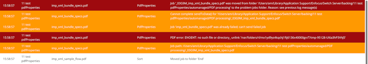

2. The first time the script works fine, the second time it gives an error.
I took the script from GitHub repository and did not change it.
Screenshot 2023-04-18 at 16.08.17.png (81.48 KiB) Viewed 12786 times
Where should I look for the problem and a solution?

Hi Arsen,
This problem happens because the second time the job is processed, Switch fails to add the dataset with the same name. It does not replace it by default. 2 solutions:
  • use Export metadata and remove the dataset before processing the job a second time
  • edit the script and remove the dataset before adding it:
        try {
            await job.removeDataset(datasetName);
            // await job.log(LogLevel.Debug, `Removed dataset '${datasetName}'`);
        } catch (error) {
            // dataset does not exist
            // await job.log(LogLevel.Debug, `Dataset '${datasetName}' did not exist`);
