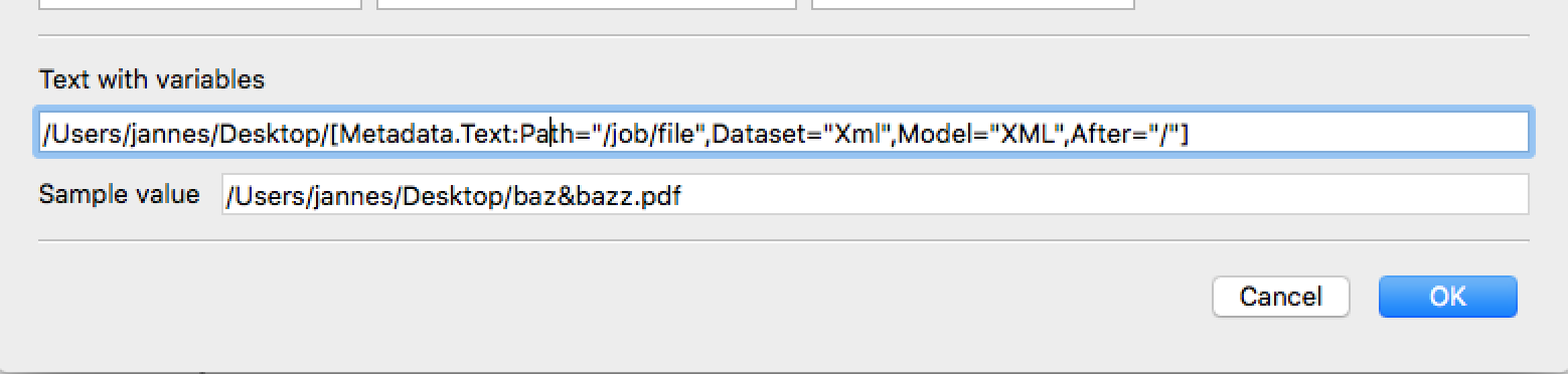

The XML pickup tool will handle the & and translate it to the proper baz&bazz.pdf filename. As long as the XML is valid it will work in Switch. The inject tool will pickup your file.
