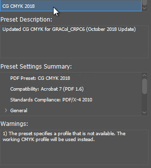

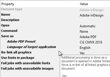

What if you try your preset in InDesign itself? Do you get an error message or some warning?
The "user cancelled this action." can appear when a modal dialog tries to open but can't cause of one already displayed.
Feel free to send screenshots of both your Switch InDesign Configurator settings and your Indesign PDF presets window.

Post by ConquestUser »
I've attached the screenshots of the setting. Very basic.

Hi
Can you run this little script inside indesign and see if you get the same error? The guess is that a dialog tries to pop-up. Maybe some warning of some sort:
var doc = app.activeDocument;
var preset = app.pdfExportPresets.itemByName("CG CMYK 2018");
doc.exportFile(ExportFormat.PDF_TYPE, File(Folder.desktop+"/test.pdf"), false, preset);
Note that this script will only work if:
- a doc is open (preferably the one which "fails" within Switch
- You have a PDF export ^preset named "CG CMYK 2018" installed
We want to see if an error message pops up inside InDesign.

I actually got the preset to work by copying the high quality preset and then editing it. Now My issue is Illustrator. Every file or package I try to send to the Illustrator app fails.
