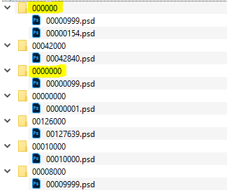

Hi tdeschampsBluewest,
thank you for this clever solution and especially for the explanation!
Unfortunately, there is still an error (see screenshot).
Because of the better readability I used only the "start folders", i.e. the first part of your formula. So the folders should be as follows:
00000000
00002000
00004000
00006000
Strangely, for file names between 00000010 and 00000099 (6 leading zeros) or 00000100 and 00000999 (5 leading zeros) a separate folder with 6 or 7 zeros is created. Actually, these files should also be sorted into the folder with 8 zeros.
For files with 7 leading zeros (e.g. 00000001.psd) this also works correctly.
Do you have an explanation for this?
Thank you very much for your great and helpful support!
Kind regards,
Peter

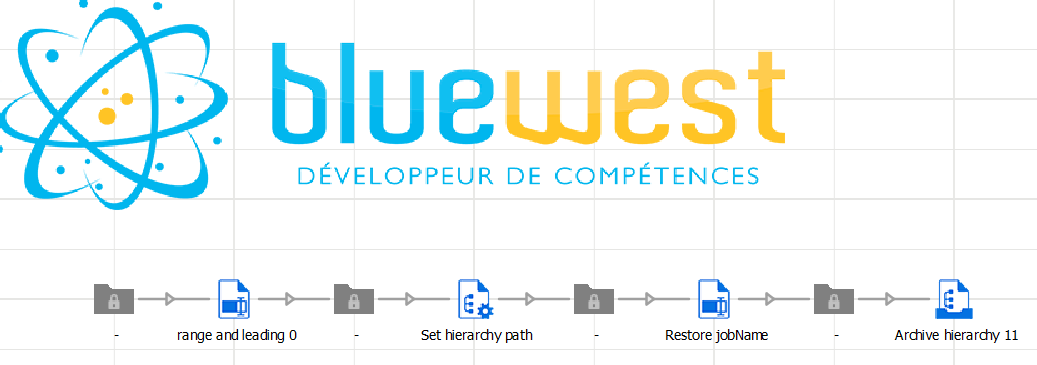

Effectively, for file under the range index number of digits (4) and above 9, some problem can happen.
For example with 00000999 : the regex part will give 00000 the calculation part will give 0, and that's not the wanted number of digits.
Another solution, if you have the last version of switch + the new rename element version, is to use the "Add leading 0" action.
See example here
See example here
