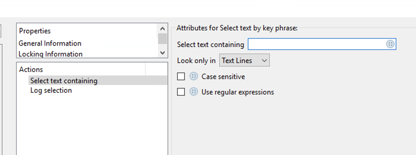

There is an option to 'Select text containing' in Pitstop. Then you can log selection as warning.
For routing the file you can use the Pitstop XML-metadata or the orange warning outgoing connection.
You can use a Switch variable if your specific phrase is variable.

mpeapell
Posts: 3
Joined: Fri Aug 11, 2017 10:42 am
Location: Swindon, UK
Re: Extract Text from PDF for Metadata/Private Data Use
Post by mpeapell »
Thank you... this is perfect!
