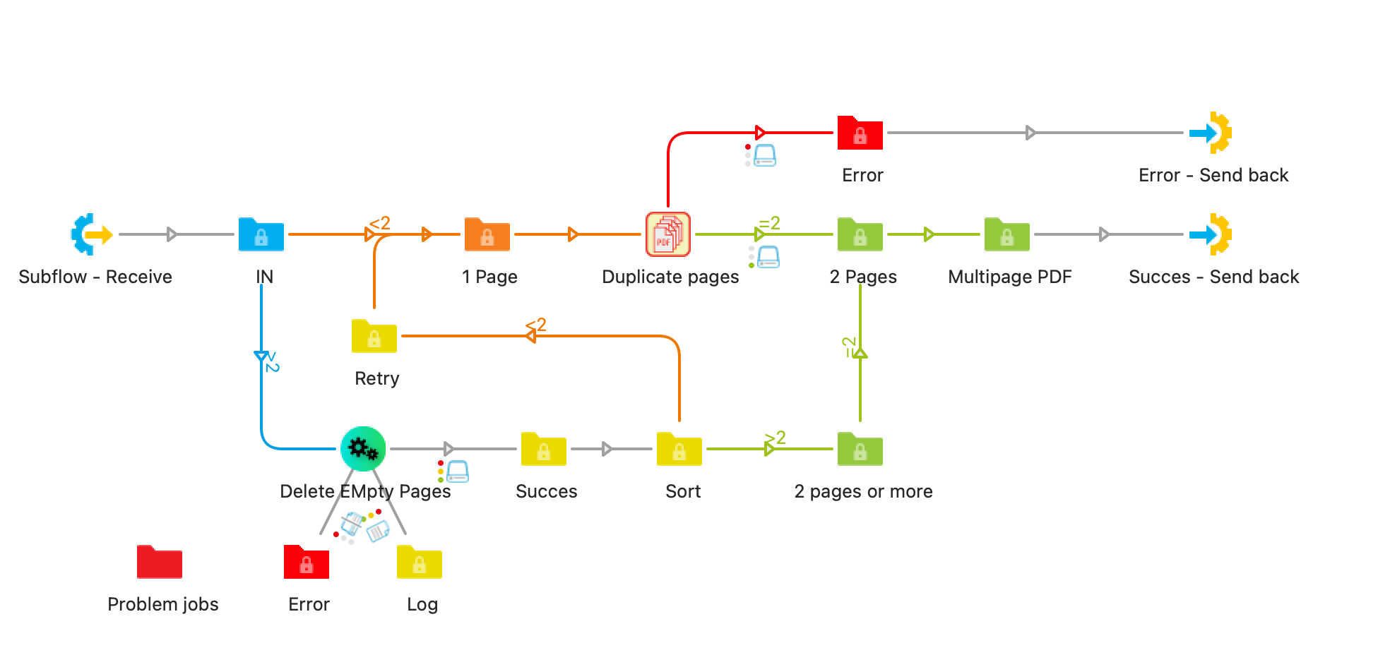

Indeed, look for Duplicate Pages in the Appstore. I use Duplicate Pages to prepare PDF files that need to be printed double-sided in a Subflow.
Duplicate Pages.png (115.91 KiB) Viewed 24693 times
