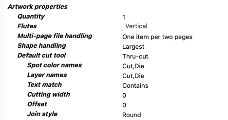

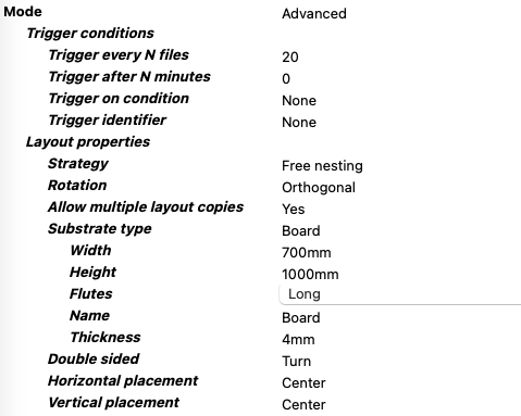

Hi Egon,
Please try this:
  • Use advanced mode
  • Define flutes direction on your substrate
  • Define flutes direction on your artwork
Griffin app Flutes 1.png (47.63 KiB) Viewed 21342 times
Griffin app Flutes 2.png (30.98 KiB) Viewed 21342 times

Hi Laurent,
Serious? Totally missed those Artwork proportions! It can be that simple!!!
Thanks Laurent! :D
