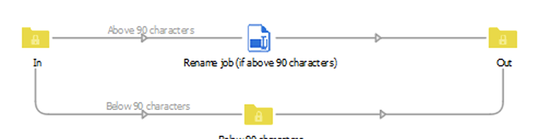

I have done a similar thing, similiar to Freddys idea. Maybe this helps:

Thanks Magnus for the example.
In my current use case I will use the other idea with scaling the content, which overlaps the media box.
