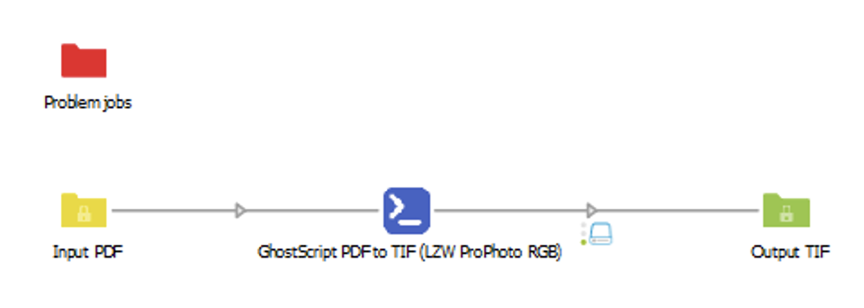

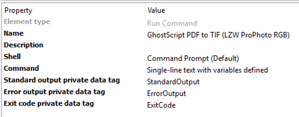

After a bit of trail and error I solved it with Ghostscript and Run Command, I'll share the solution here if:
Command:
"C:\Program Files\gs\gs10.02.1\bin\gswin64c.exe" -dSAFER -dBATCH -dNOPAUSE -sDEVICE=tiff24nc -r300 -sCompression=lzw -sImageICCProfile=e:/icc/prophotorgb.icc -dRenderIntent=0 -sOutputICCProfile=e:/icc/prophotorgb.icc -sOutputFile="[Job.NameProper].tif" "%%InputFilePath%%"
