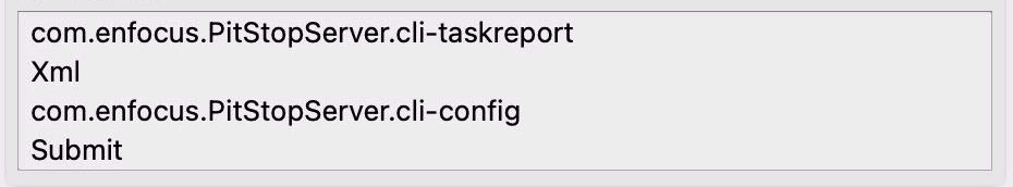

Just a quick update.
I have 4 datasets associated with the PDF, I removed/exported all but the 'Submit' one and still get the error.
Screenshot 2023-11-30 at 7.05.46 AM.png (62.81 KiB) Viewed 31334 times
