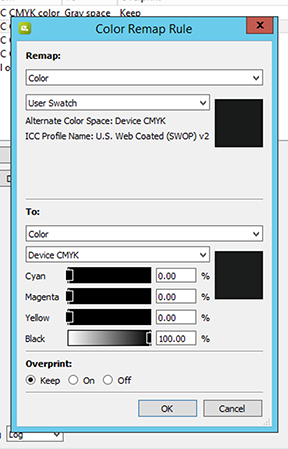

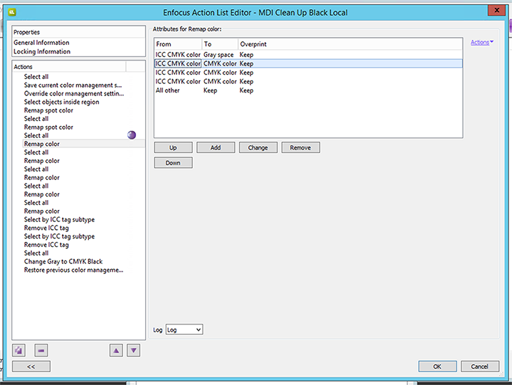

I added to the 'Clean Up Black' action list in PitStop Pro 2021 to remap various known 4C Blacks our clients use. These colors all have ICC SWOP v2 profiles on them. The action lists work in PitStop Pro 2021, but when importing those actions to PitStop Server 2021 and test, PitStop Server ignores the whole action lists where I have the 'ICC CMYK' remap colors programmed.

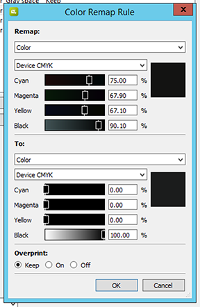

I was able to update the action list where I; 'Select All', 'Remove ICC tag'. Then instead of the 'ICC CMYK' User Swatch, I can define a 'Device CMYK' Swatch with the same numbers to convert to Device CMYK Black.

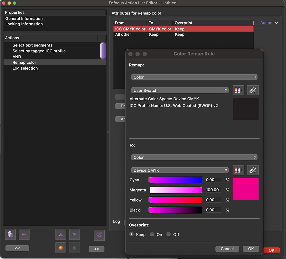

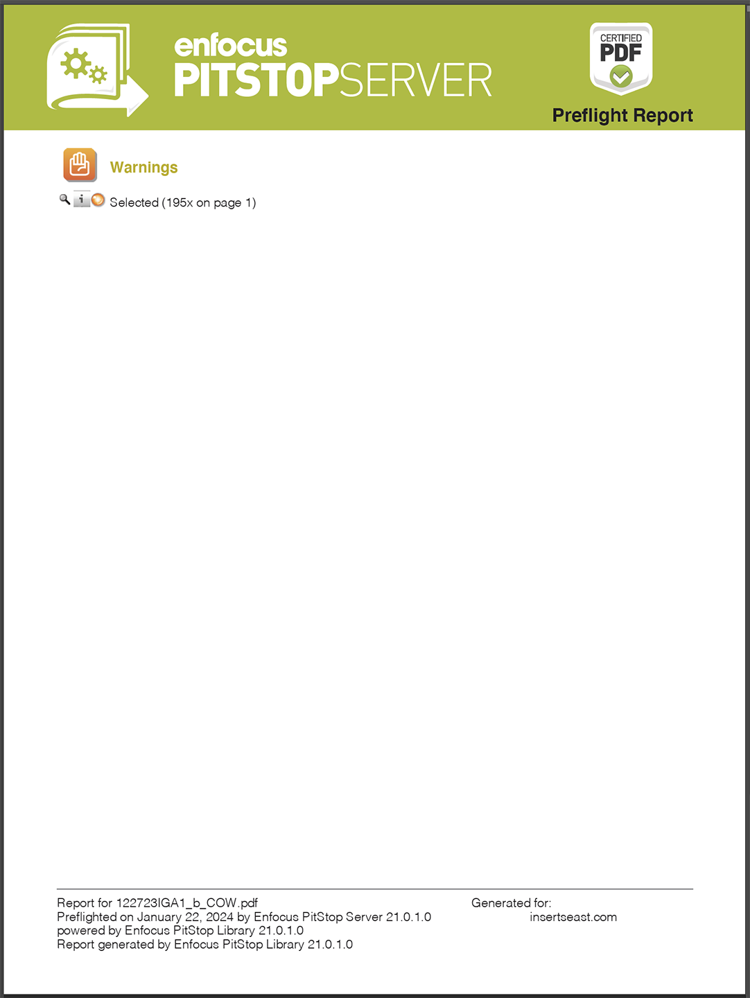

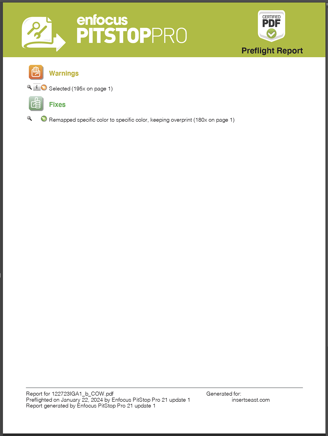

I created a simple script to Select All, Remap the (1) color ICC SWOP v2 100% Black, to just Device CMYK 100% Magenta, and Log Selection. Again it works in PitStop Pro, but not in PitStop Server. Server only selects all and ignores the remap action. I tried updating the action to select only text segments with an ICC profile. Still Server only selects and ignores the remap action.

Very odd. I think this should work, but I must be missing something. Apparently the "Remap color" action thinks the colour in the PDF doesn't match the one in the Action List. This could be a rounding in the colour values, or a difference in the ICC profile. Rounding is less likely, so I'd guess a difference in the ICC profile. There are a lot of subtleties that are impossible to see without checking the profiles in detail. But if PitStop Pro thinks the ICC profile is the same, then PitStop Server should too.
Could you try with a newer PitStop version? If that also doesn't work, I suggest you contact Enfocus support.
