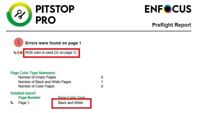

Hello,
I want to use my action list to determine whether my digital press is accounting for black and white or color prints.
So I have three questions about this:
Why does the Page Color Type Report confirm black and white even though the PDF contains a neutral RGB Black? A neutral RGB Black (where the R, G, and B values are equal) is seen as color by the _original_ DFE and costs a 4-color click and not a black and white click.
Our DFE is a PRISMAsync from Canon and accounts for a 4color click when outputting such neutral RGB, not black and white.
Since Enfocus/PitStop provides the Page Color Type Report specifically for DFE users like me, that should be corrected.
If I can't rely on the result, then the preflight report "Page Color
Type" or even the action "Gather page color type" is completely useless.
It would be desirable that neutral RGB is recognized and reported as color, just as it is interpreted by the DFE! Because then I would also have the possibility in advance to correct the print data in time.
I have already contacted the enfocus support. In their reply, they unfortunately do not explain why rgb is reported as black:
To explain more about the Page Color Type Chapter in the Preflight Report was created specifically for DFE (Digital Front End) customers who pay a different amount for color pages than for black and white pages.
This reports on the Color Type of a Page, with three possible options that will be reported: Empty, Black and White, or Color. The report emulates a DFE and has the following specific handling:
Neutral RGB = Black and White
K only = Black and White
Perhaps someone here can explain to me what the point is of reporting neutral RGB as black and white in the Page Color Type Report, when the same RGB is billed as a color on the original DFE of the printing press.
Regards yosimo

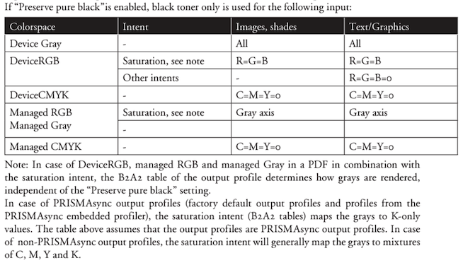

Yes, there is a misunderstanding. On your part. I have just received feedback from Canon which confirms what I thought: "Preserve pure black" also applies to equal values of RGB. Here is the feedback:
Screenshot 2024-01-23 at 15.37.54.png (159.18 KiB) Viewed 47583 times
I'll say it again: getting a correct page color type report requires knowledge of the behavior of the output device settings and may therefore require some tweaking on the PitStop side. As I explained in a previous reply: if you want to force the interpretation of neutral RGB as color you can tag RGB objects with an ICC profile and convert them to CMYK. And as I also wrote: it would be nicer to have an option/toggle/checkbox in the "Gather page color type" Action, but that does not invalidate the need to align PitStop with whatever settings you are using on the DFE side.

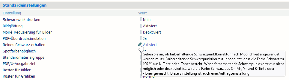

Thank you for this very interesting information. I was not aware of this before. I cannot find these settings on our PRISMAsync DFE.
I have therefore sent a request to our Canon Integration Specialist and am still waiting for an answer.
I could only find this on our DFE:
Get pure black is already activated and still our DFE clicks an RGB black as color.
...to force the interpretation of neutral RGB as color you can tag RGB objects with an ICC profile...
That's not necessary, our DFE already interprets it as a color anyway. Before printing, I want to know which pages will cause a black and white click and which pages will cause a color click, just like a simple preflight.
But I don't want to reconfigure the DFE so that the print settings match the Page Color Type Report. It should rather be the other way around.
Therefore I agree with you, if you could configure the action Gather page color type: for RGB black report colored or black-white page type, depending on how the DFE interprets it.
