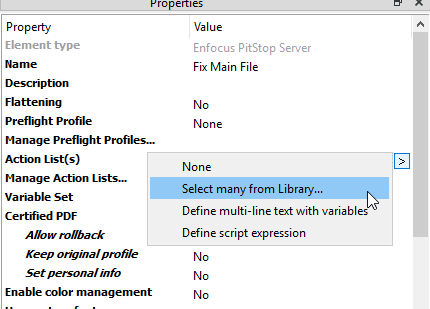

I believe this is what you're looking for. Under Action List(s), choose 'Select Many from Library.'
Select Many from Library.png (11.31 KiB) Viewed 36923 times

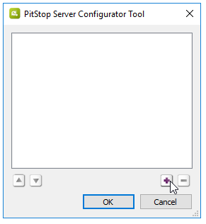

In the Pitstop Server Configurator window, click the Plus button at the bottom right corner.
Click Plus.png (5.13 KiB) Viewed 36923 times

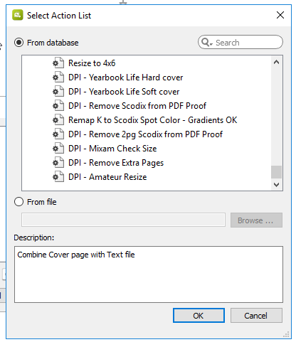

This will bring up the list of actions for you to choose from.
Pick from list.png (13.66 KiB) Viewed 36923 times
