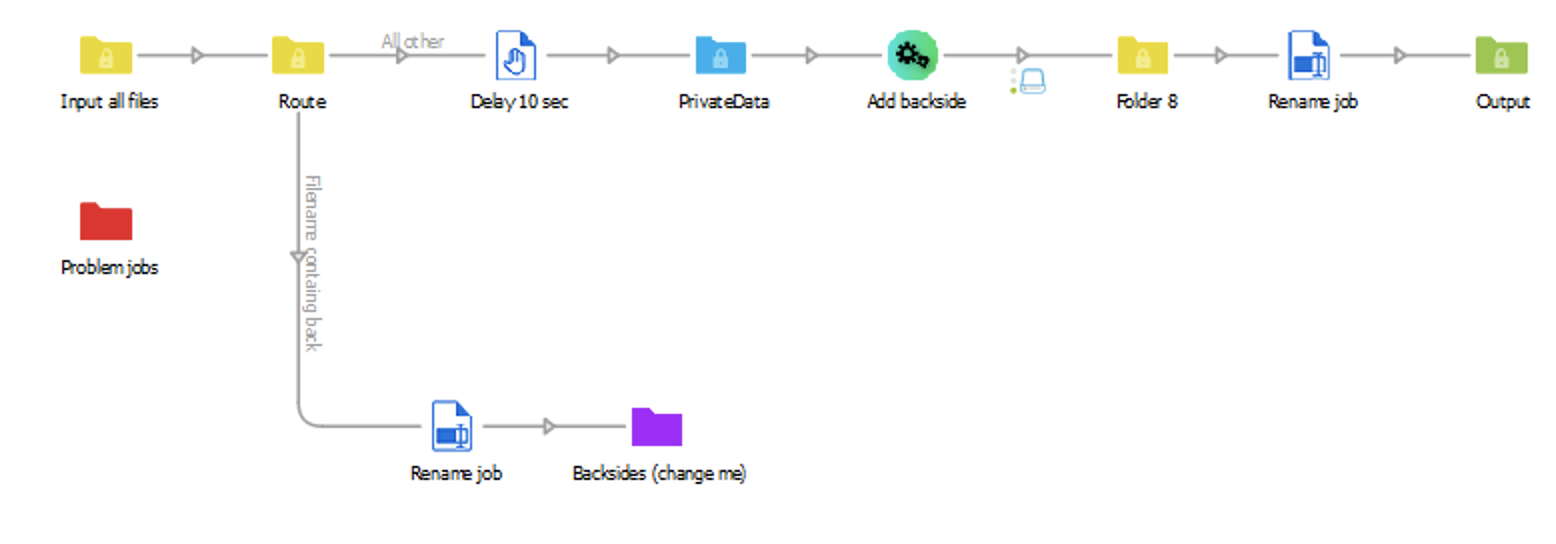

Here is a flow that does what you asking for (zip-file in the bottom).
  • The file names of both fronts and backs must start with the same id followed by an underscore.
  • The file name of the back must contain the word back
Like this:
0001_My filename back.pdf
0001_My first front file.pdf
0001_My second front file.pdf
And so on...
You need to change two things in the flow:
1. The path in the Backsides folder (purple)
2. The variable url_to_backfile in the Enfocus Varible Set add_back. Set it to match the path to the backsides folder (in windows you need to replace backslash with forward slashes).
add_backsides.zip
(44.75 KiB) Downloaded 938 times

Post by MJDS »
This works really well thanks for your help
