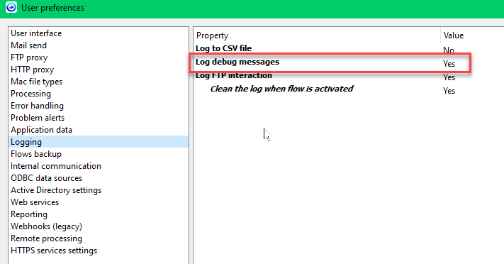

Have you enabled the Debug mode in your Switch? If so you should see some HTTP messages from the server you call in the Messages.
You set it in the preferences
Jan Suhr

jan_suhr wrote: Thu May 09, 2024 6:35 pm Have you enabled the Debug mode in your Switch
I have, and no additional debug messages are generated. The entire effort the last few days on this alternate flow have been a failure. I appreciate the help, but unless someone here has a magical solution I'm done wasting my time on it any further.
