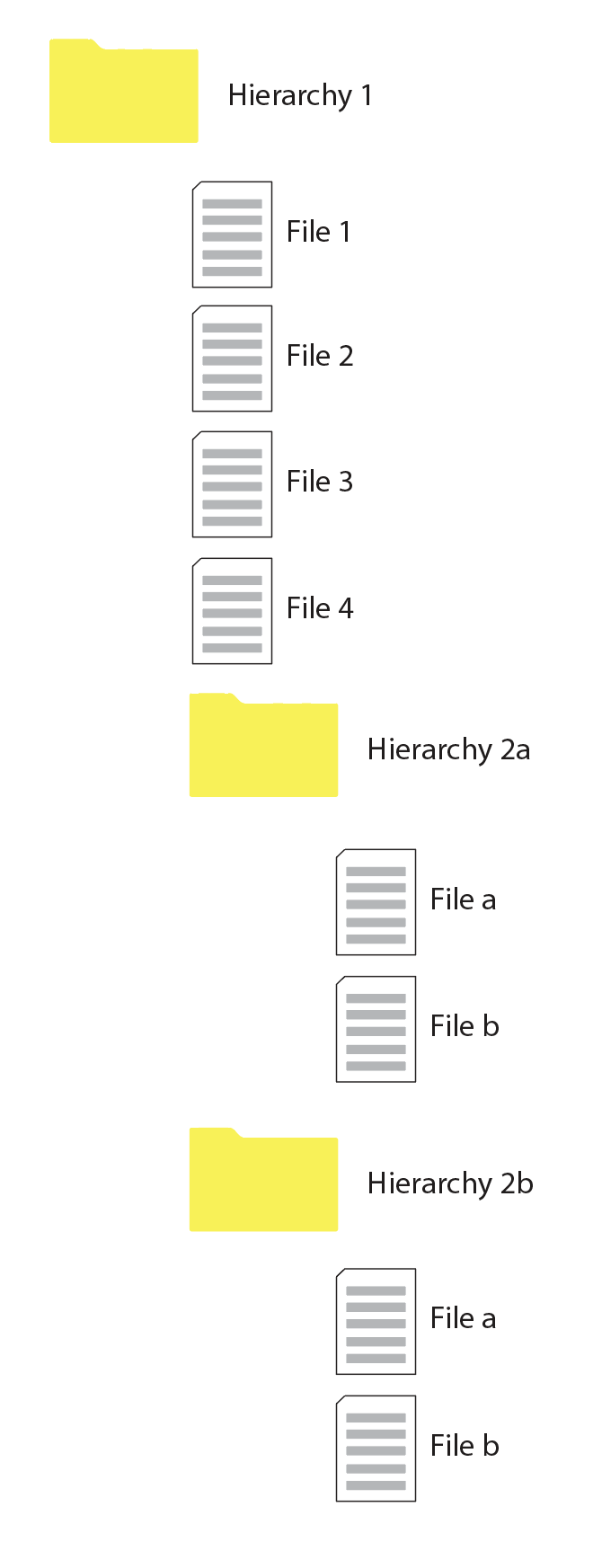

Let's say we have a submitted hierarchy that will run through the flow:

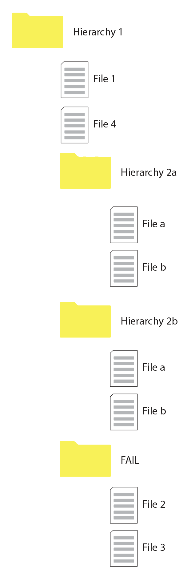

During the flow Files 2 and 3 are failed, so a FAIL hierarchy 2 is added and they are moved to it:
My goal once the flow is finished and it hits the Archive Hierarchy is to send the entire Hierarchy 1 (folders and contents) along one path if there is a FAIL subfolder and along a different one if there is not. I downloaded the Inject Wildcard app and will give it a shot, but my first attempts are still splitting everything up.
