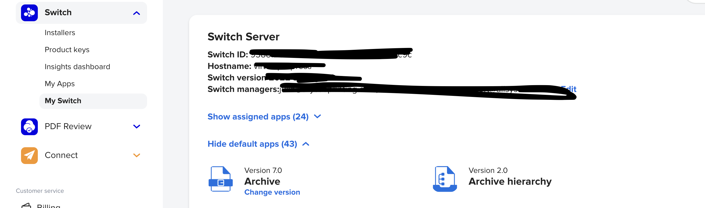

Hello, I am running Switch 2024 Spring. My server is registered to the appstore.
I have several default apps that say there is an update to them, but they are not updating.
Apps not updating:
XML Pickup
Opaque Pickup
JDF Pickup
File Type
Export metadata
I do not really use these, but my bell icon keeps telling me there are updates available. I click the refresh button and i see a spinning icon, but nothing gets updated.
Any suggestions?

Go into'My Switch' section in your Enfocus account under Switch. Click the carat to open the default apps from there you can select the speicif app and assign the versions from there.
Screenshot 2024-08-08 at 10.12.24 AM.png (166.89 KiB) Viewed 144681 times
