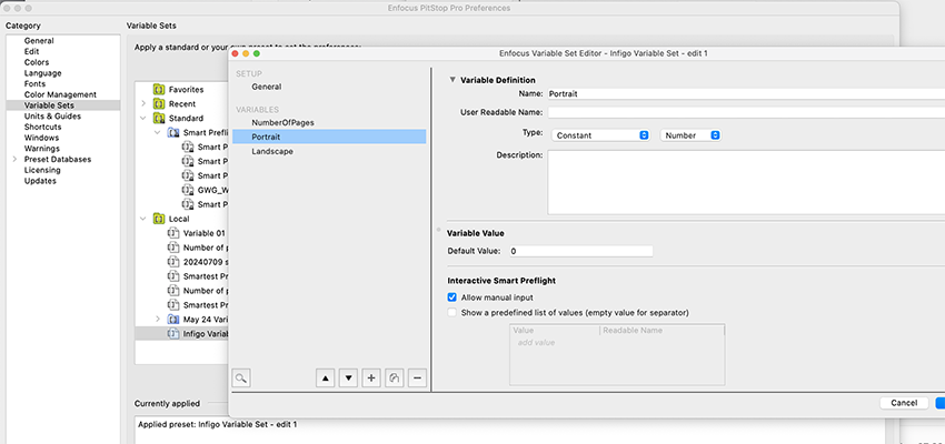

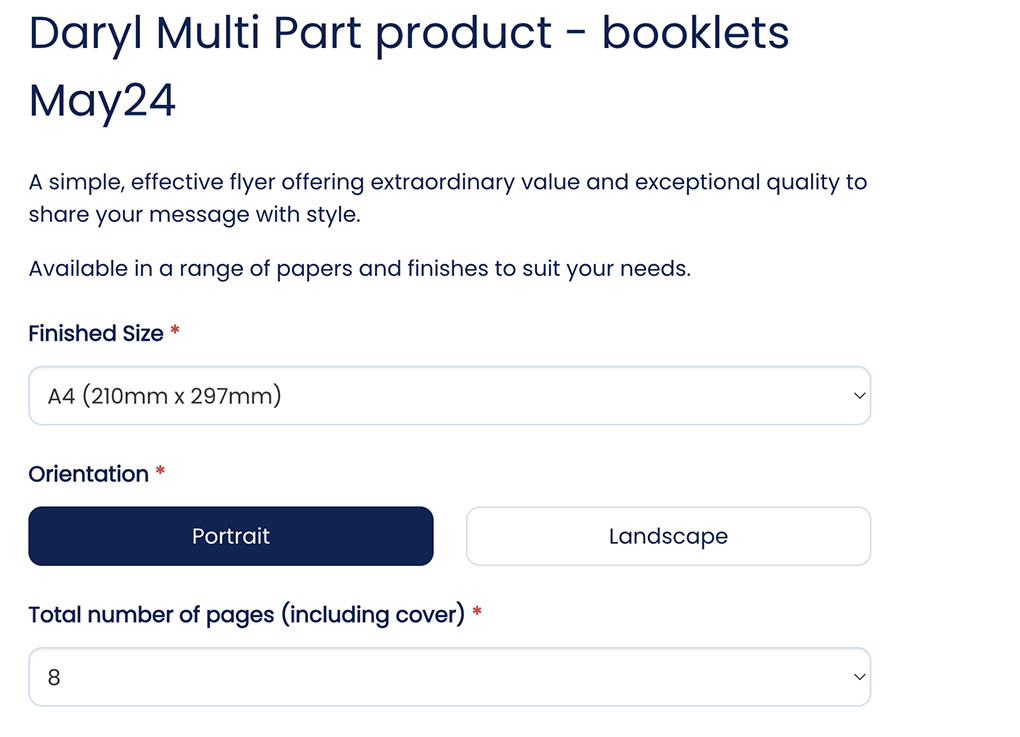

DJS
Posts: 71
Re: Check variable sizes
Post by DJS »
Thank you for your reply.
My reason for asking is that I am really struggling to create a PPP in Pitstop Pro which draws the information from XML where the information is set by the customer on the splash page (all on the infigo web to print platform - I have no access to their Pitstop server).
Screenshot 2024-07-08 at 13.52.52.png (128.38 KiB) Viewed 33228 times
I need a PPP which will check the size/orientation/page extent plus the usual checks to make it print ready (RGB to CMYK etc).
I have the PPP working in a basic form locally but have to write the XML, which is when nothing works... I am desperate to understand how this all works and what I am doing wrong, and the simplest way to do this correctly, I have tried to add the PPP but it is 517kb so wont upload

What I would suggest here is to create 2 action lists:
  • One that checks for Portrait
  • One that checks for Landscape
Then have a preflight profile where you add the two checks (your Action Lists from above)
Then condition their execution (enable variable names) with your Portrait or Landscape variable.
With all of that, you should get it working.

Thank you for your assistance Loic, Sorry, I have searched the forums and enfocus learning, I need to recreate the variable preferences as I don't have access to the host server , might you have something available to show me how I should populate this?
Screenshot 2024-07-10 at 08.29.54.png (99.72 KiB) Viewed 33152 times

Posts: 782
Post by loicaigon »
Will the PDF be processed in a Switch flow?
Loic
DJS
Posts: 71
Post by DJS »
The PDF will be processed online (Infigo web to print) via their PitStop Server 2023.
loicaigon
Posts: 782
Post by loicaigon »
Ok, I am not familiar enough with Infigo products, nor if they provide setup assistance. So I can only speak from an external point of view.
If you only have access to PitStop Pro, you cannot point to a XML Job Ticket. You need The PitStop Server Desktop app for that because variables would refer to a job ticket:
Then you could fill parameters as they seem to require: https://infigosoftware.zendesk.com/hc/e ... t-Profiles
Right now, you either need a PitStop Server Developer License or simply run a trial. Unless, of course, Infigo can help you setting this up.
Loic
