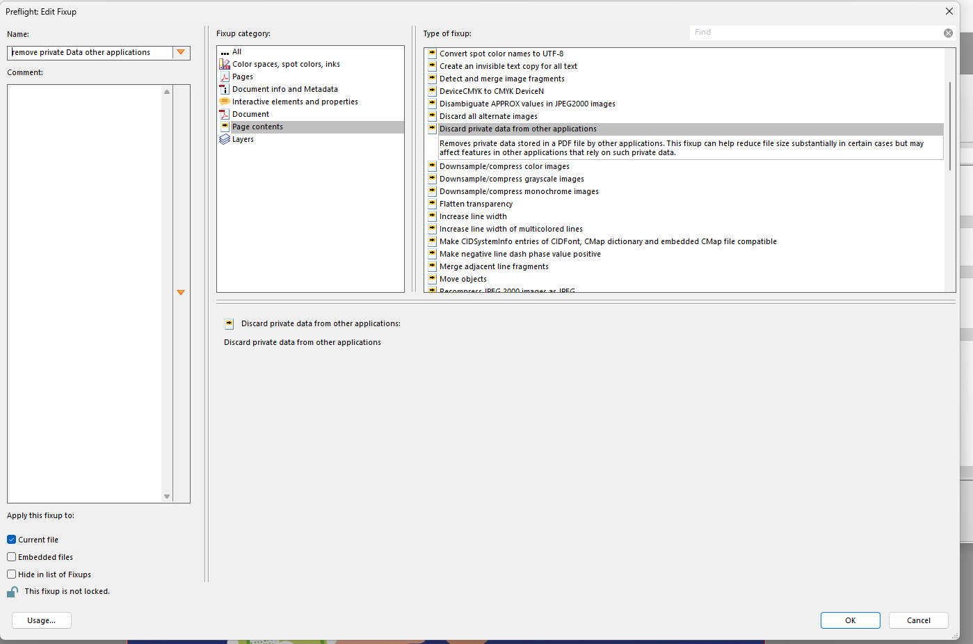

private data from another applications
Post by flussidicaio »
discard private data.png (51.91 KiB) Viewed 20088 times
I can't find an action that removes "private data from another applications" like the related preflight command that is present in acrobat.
is there somethings like this?

This is planned for a future release.
Thanks for your patience.

If you want to use the acrobat action anyway, you could create a droplet doing this action.
It will be a .exe file, that can be executed with Execut Command app, and it will perform the desired action.
I use this notably to flatten PDF using acrobat engine instead of Pitstop one in some edgy pdf.

I solved it using a preflight inside acrobat launched from Switch
