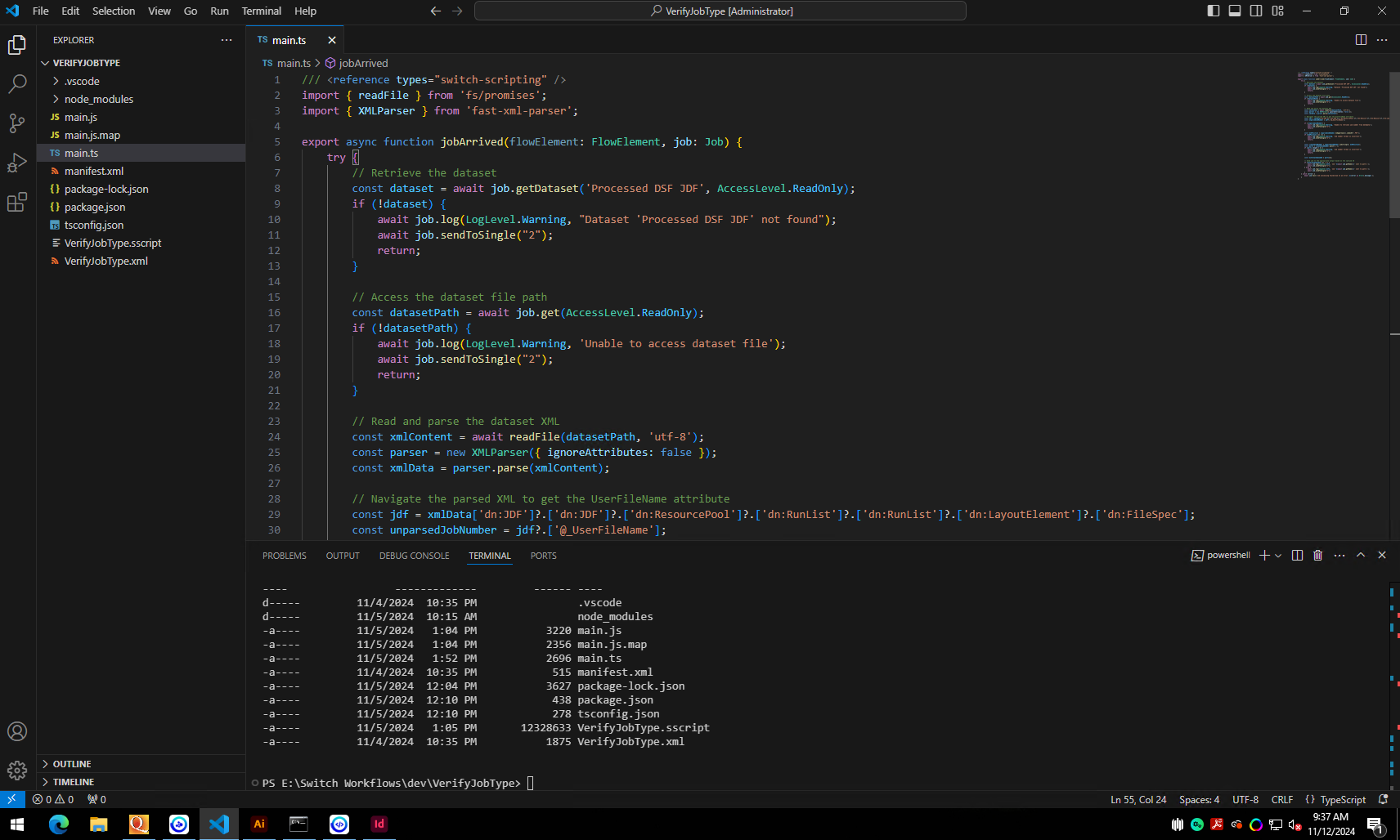

Hello all! I'm getting an error when running my workflow that has a Node.JS script element in it. I'm running Switch Spring 2022. I'm working on these script updates because I need to update to a newer version of Switch but I have a TON of legacy scripts that need to be converted to Node.JS so I'm starting with a small/easy script and it's not going that great ;)
The error I'm getting is:
undefined is not a function TypeError: undefined is not a function at jobArrived (C:\Users\enfocusswitch\AppData\Roaming\Enfocus\SwitchProcessorService\cache\7ce230b50ef35d1b9adecf311dd1baa99d4fdea10c8394276d9b97258fa46f44\1731425389\main.js:1:3647) at _0xbe11ff (C:\Program Files\Enfocus\Enfocus Switch\ScriptExecutor\nodemodules\node_modules\switch-scripting\index.js:1231:34) at C:\Users\enfocusswitch\AppData\Roaming\Enfocus\SwitchProcessorService\cache\7ce230b50ef35d1b9adecf311dd1baa99d4fdea10c8394276d9b97258fa46f44\1731425389\main.js:1:5847 at AsyncResource.runInAsyncScope (node:async_hooks:201:9) at C:\Users\enfocusswitch\AppData\Roaming\Enfocus\SwitchProcessorService\cache\7ce230b50ef35d1b9adecf311dd1baa99d4fdea10c8394276d9b97258fa46f44\1731425389\main.js:1:5504 at new Promise (<anonymous>) at entrypointWrapper (C:\Users\enfocusswitch\AppData\Roaming\Enfocus\SwitchProcessorService\cache\7ce230b50ef35d1b9adecf311dd1baa99d4fdea10c8394276d9b97258fa46f44\1731425389\main.js:1:5321) at C:\Users\enfocusswitch\AppData\Roaming\Enfocus\SwitchProcessorService\cache\7ce230b50ef35d1b9adecf311dd1baa99d4fdea10c8394276d9b97258fa46f44\1731425389\main.js:1:7539 at _0x1a94d4.run (C:\Program Files\Enfocus\Enfocus Switch\ScriptExecutor\NodeScriptExecutor.js:429:30) at async process.<anonymous> (C:\Program Files\Enfocus\Enfocus Switch\ScriptExecutor\NodeScriptExecutor.js:280:41)
I used the Switch Scripter tool to create my directory structure, I then programmed everything in my main.ts file and configured other files as necessary. In my SSCRIPT, I linked to the main.ts file that I put my code into. The script is designed to read an XML file, see if a field has a _1 or something else and, depending on that field, is supposed to send the file down a specific path.
Here's the code for my main.ts file:

Again, I'm new to this because I've been using Legacy Coding for years and now have to make the switch to Node.JS.
What am I missing? If you need more information or need to see code from other files, let me know. Also attached is a screenshot of my folder structure inside of VS Code.

After debugging your script I think I was able to find your issue. The jdf variable you'd defined that queried the parsed xmlData was returning undefined
As you can see from the screenshot below when debugging the value of the xmlData variable the properties within it don't contain any "dn:" prefixes:
I think all you need to do to get the code working as you expect is to update the this line:
const jdf = xmlData['dn:JDF']?.['dn:JDF']?.['dn:ResourcePool']?.['dn:RunList']?.['dn:RunList']?.['dn:LayoutElement']?.['dn:FileSpec'];
to this:
const jdf = xmlData['JDF']?.['JDF']?.['ResourcePool']?.['RunList']?.['RunList']?.['LayoutElement']?.['FileSpec'];
