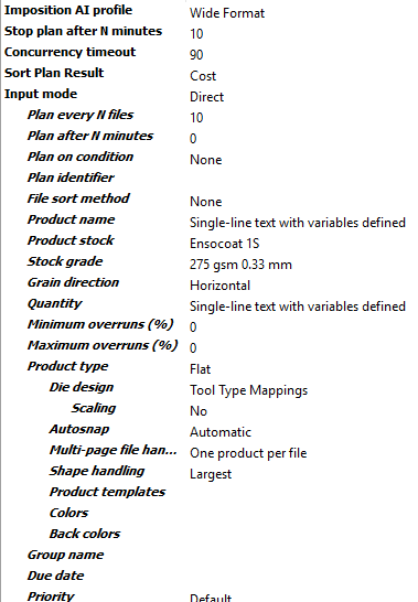

We are facing an issue with impositioning duplex flatwork.
The input consists of duplex flatwork, and based on the JSON data, the PDF is duplicated X times in Phoenix.
The setting in the imposition AI profile is set to "Wide format" because we want to duplicate the PDF in Phoenix. The finishing process in Phoenix uses duplex sheets, which can accommodate two-up imposition.
However, the "cut and stack" option won't work, as far as I know.
The issue arises when the output is uneven, causing the last PDF to be placed in the middle of the stack.
What we want is for the last file to be placed on the left side instead of the middle.
In my opinion, this should be achievable without the need for any plugins in Switch.

these are the switch settings for the phoenix2switch app
