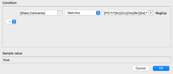

The [Stats.Colorants] is a good approach. Checking the presence of a regular expression is easily done in a condition with variables with the operator "Matches".
[Stats.Colorants] returns something like Black;All;Die;Varnish, so with a condition like this:
Spot color condition.jpg (24.56 KiB) Viewed 65065 times
true means one of the spot colors of the regex is present and jobs that follow "All other jobs" do not such a color.
Another fast approach is to use the FastLane app: https://www.enfocus.com/en/appstore/product/fastlane. You get the color information in a dataset and you can query that. In this case the solution above is easier to implement.
