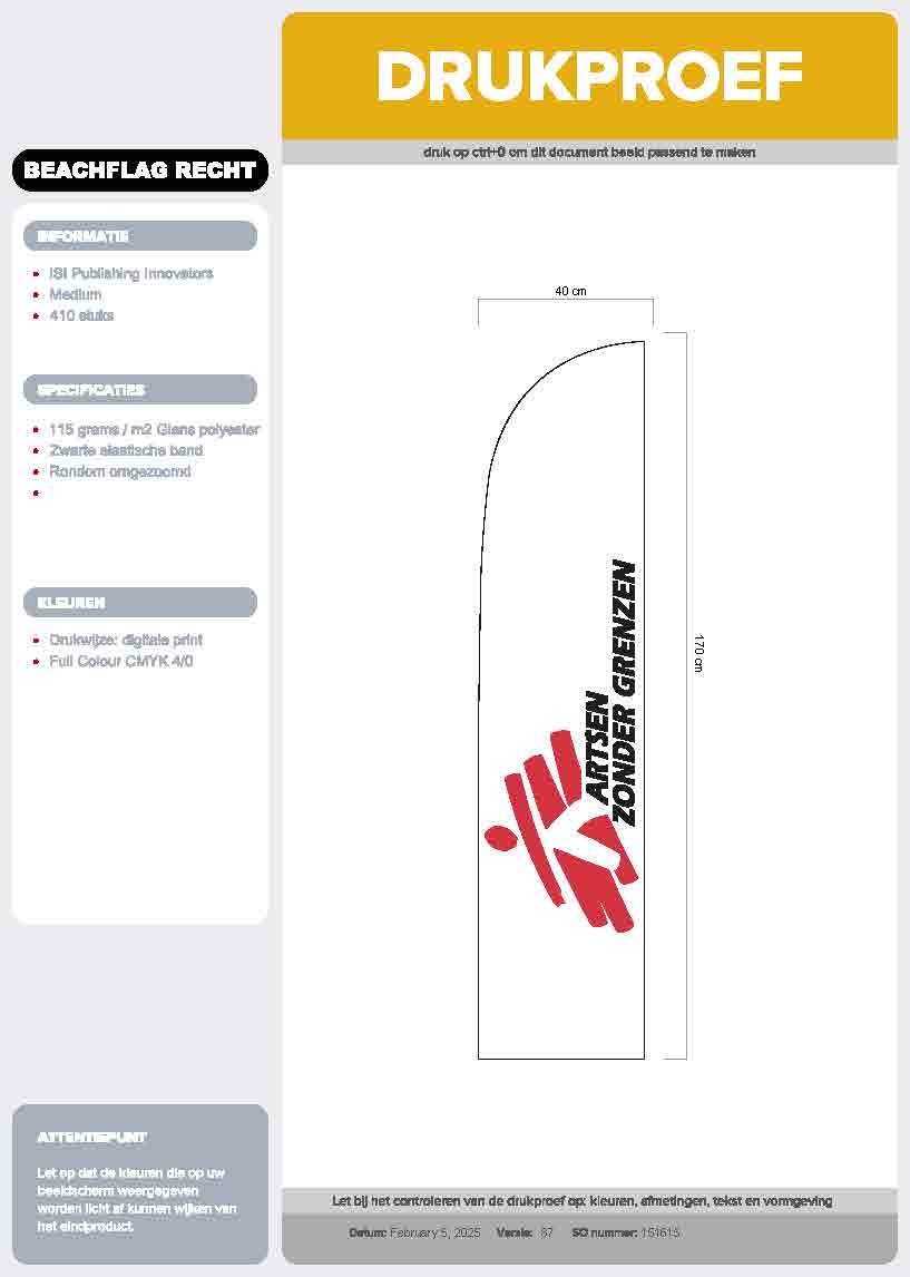

I need to make a contact/proof sheet. i know this is possible within pitstop. Does anybody have a action flow is can use?

Well guys i got in contact with a company here in Netherland and for 150 euro i got 2 actions for pitstop that makes a proof just like my example.
